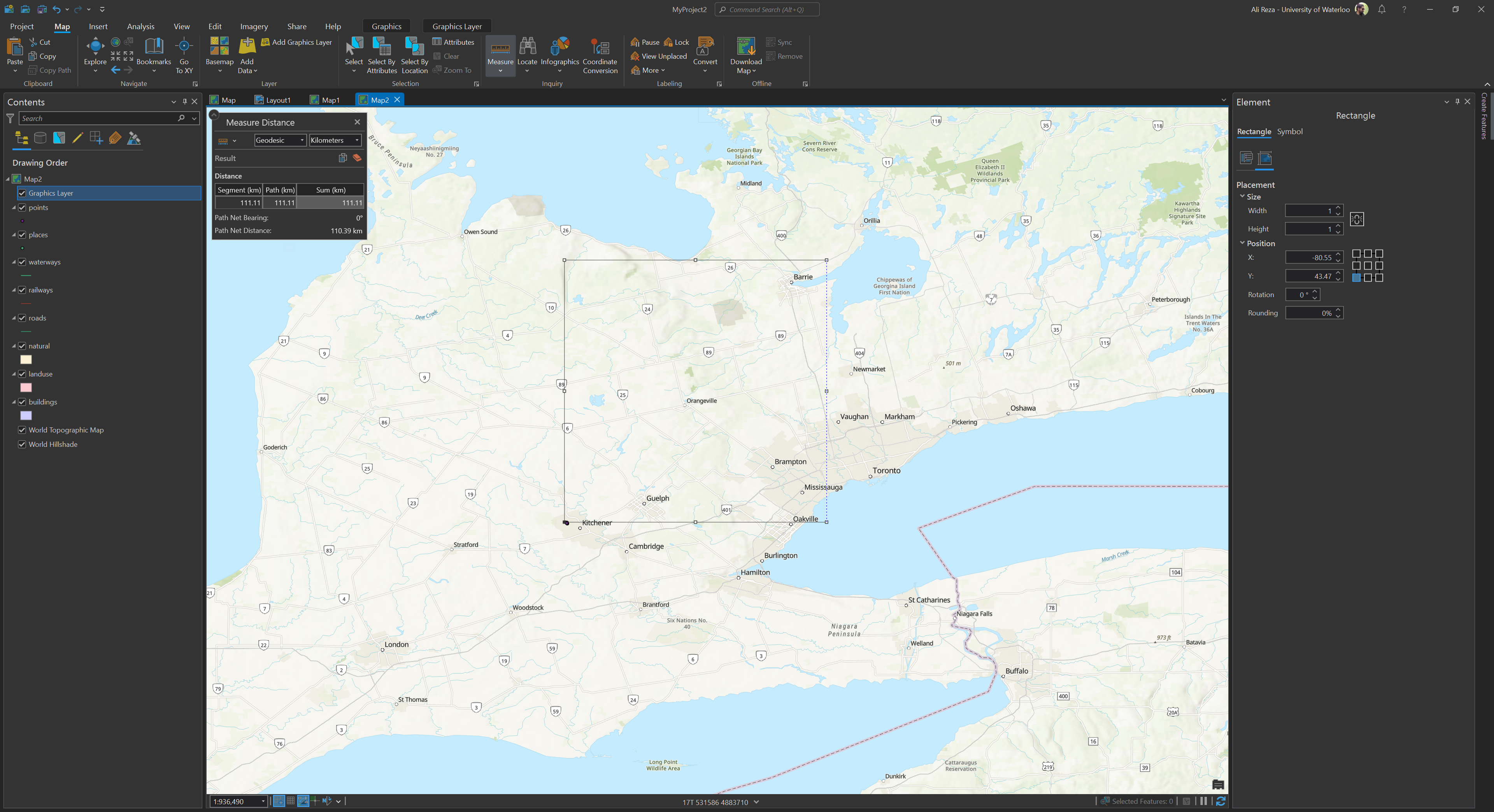

I would like to draw a square using 'Graphics Layer', but when I attempt to set its size to 1m by 1m using the properties of the drawn object, it becomes excessively large. The attached screenshot shows that a 1 x 1 (units unknown) square is being displayed as 111.11 km by 111.11 km!Screenshot (915).png

I'd guess your dataframe (map coordinate system) is in a Geographic coordinate system such as WGS 1984.  The map units will be planar equivalents of 1 degree at the equator (111km).  Change to a planimetric coordinate system and set the properties, then switch back if necessary.
You could also create a feature with set length and width and convert to graphic after.
https://pro.arcgis.com/en/pro-app/3.1/help/editing/create-squares-and-rectangles.htm
https://pro.arcgis.com/en/pro-app/latest/tool-reference/conversion/features-to-graphics.htm
