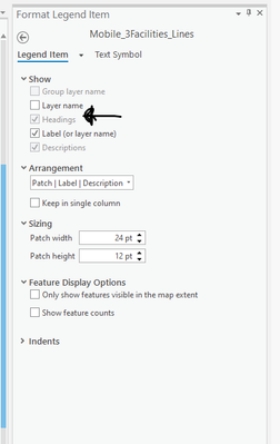

Question, why is the "headings" greyed out and it won't let me turn it off? It's just a simple point feature class.

I'm having the same problem. I inadvertently did something within the last hour and how can't get rid of these legend headings  on any of my 20 layouts.
MichelleAkamine
I was having the same problem and just figured it out!!!! Within your table of contents, under your legend, click on the layer that has the heading you want to remove. This opens up the format legend item pane. Now you should be able to uncheck the heading under the Show dropdown.
Teresa_Blader
Ah, yes. I had multiple items in the legend selected instead of just the one! Thanks!~

MickWheaton
Was just struggling with this myself. You can have multiple layers from the Legen item selected, they just all need to be layers that actually have a Heading to toggle on/off.
