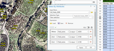

Agree, Linda's answer and the join field tool is awesome, but what if all i need to do is export say 10 fields as a new layer, so all i want to do is select them so i can export feature. The select by attribute works, but i have to select each field from the list of 800 one by one. So i figured there would be a quicker solution. Bud is on the right track and I will try that. Thank you!
Here is a screenshot of me trying to fill out the select by attribute that is very slow. It also shows my list coming from excel that I would love to copy and past to somewhere to easily select all of those.

A simple way which would only take a few minutes would be to use an excel formula to take your strings into a format such as below (slide the syntax bar to 'SQL' rather than clause mode)
Field_name IN (
'X100',
'Y200',
'Z200'
 You can generate the string format using a simple excel formula such as below (replace A1 with your cell then drag the formula down for the other cells.
"'"&A1&"',"
 Copy the cells from the excel and paste them into the SQL IN statement (don't forget to remove the last value's comma for syntax)
