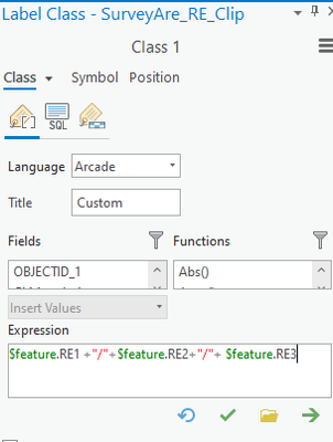

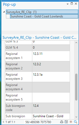

I am using ArcGIS Pro and trying to get labels in a sensible way. The layer and variables I am using to create labels can have up to five classes (Regional Ecosystems, three in the screen shot below).

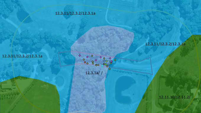

I have tried [$feature.RE1 +"/"+$feature.RE2+"/"+ $feature.RE3], which gives the below result, my issue being that when there was only one RE, there are is now // after the label which obviously looks silly.
LarissaBoundy_2-1641950934108.pngLarissaBoundy_2-1641950934108.pngLarissaBoundy_1-1641950824182.pngLarissaBoundy_1-1641950824182.png
 Is there a way to get the extra RE labels and / to only appear if the field is not empty?

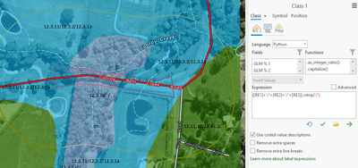

Copy-paste my script if you have changed the language to Python.
No need to use $feature. Also call the fields from the Fields list.
Please share screenshot of your label expression as well.

LarissaBoundy
Thank you, I hadn't changed language to Python, but still did not work

LarissaBoundy
Thank you so much you legend, the first one was successful.
