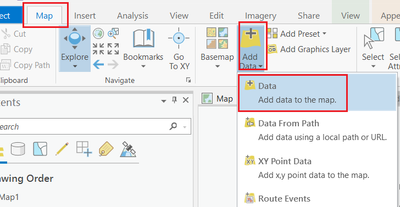

Map > Add Data > Data. Then browse to the folder containing the TIFF file(s).
Here are some useful links to get started with ArcGIS Pro.

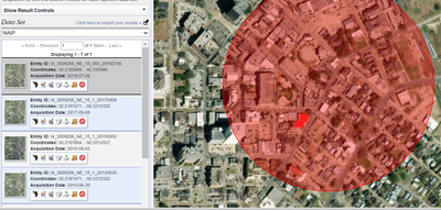

KimberlyHamm
I went to EarthExplorer and downloaded a NAIP image but I can't figure out how to open it in ArcGIS pro. I just can't seem to find any help on how to get an image in ArcGIS pro that I can manipulate in the same way that the tutorial showed. I guess it should be intuitive but I don't know how to do it and I can't find a tutorial on how to get the correct image in so that I can work on it.

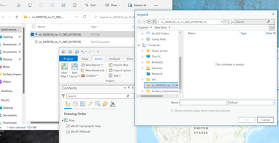

KimberlyHamm
The first image is what I'm clicking on to download map and the second is in Pro. I selected "Insert Map" but maybe this is the wrong way to go about it? The folder always appears empty when I try to add it in Pro. It is a TIF file.
