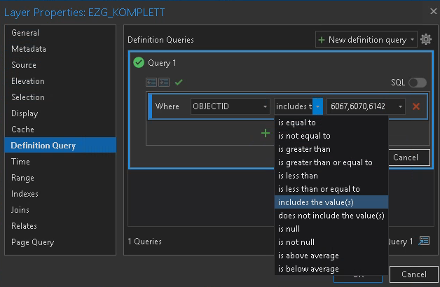

There are two basic ways of doing this:
Use a query
This would be easier if the lots had a common attribute. But for so few features, you can also use the unique key of the lots (like a parcel id or object id or globalid).

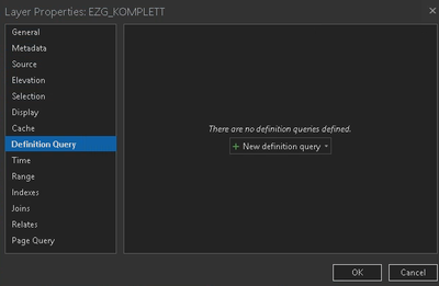

  1. open the layer's property pane (double click or right click -> Properties)
  2. switch to Definition Query
  3. click on New definition query
  4. choose your key field, "includes the values", and then write in or select the values of your lots.

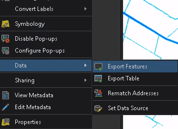

Make a local copy
You couldn't delete stuff in the layer, because you don't have thte persmission to do so. Imagine everyone being allowed to insert, change, or delete lots...
But if you make a local copy, you can then delete everything you don't need.
  1. Righ click -> Data -> Export Features
  2. By default, it will save into the ArcGIS Project's default geodatabase. If you want to save as a Shapefile (.shp), choose a folder.
  3. Type in a name, click OK.

That makes sense that I wouldn't be able to delete from the public layer, which was why I was trying to save the data of that layer locally as a separate (editable) dataset.  I tried the route you suggested and even the "export features" was grayed out.
BUT the query feature seems to work, however I am only able to display one Lot (query 1, query 2) at a time.  Is there a way to display all 49 queries for the individual lots?
