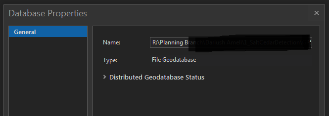

Thanks for reply. Before, I tried to delete the geodatabase based on the instructions in "Manage geodatabase locks" document, but it didn't work. It doesn't sounds normal, but previously I didn't have this "Property" option in my geodatabase right click menu! I still don't have "Connections" option, too.

The Folder I am working on is already a part of my project and the target database is in the folder. I logged off Windows and logged in again to refresh everything. The Delete option is still deactivate, though.
There is a thing! I am using my organization enterprise ArcGIS account and this problem maybe has something to do with the account administrate. I guess I should discuss this issue with our GIS department.
