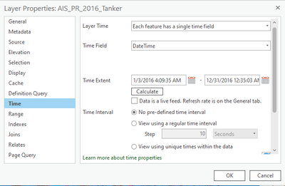

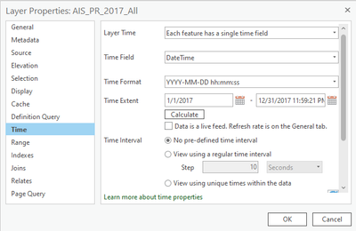

I think I might have found something buggy when it comes to enabling time on a bunch of layers which perhaps, just maybe, could possibly have something to do with why Reconstruct Tracks behaves in an intermittent fashion for me...which hopefully solves an annoying bug while leaving a moderate inconvenience wrt the ability to enable time in arcpy.  Check out the time properties for these layers in my map:
and
Where's the Time Format field in the Tanker layer?  Hmmmm...
by Anonymous User
Not applicable
Ahh good observation. This isn't a bug, although I can see how it may appear that way. The Format parameter is hidden for Date type fields. Date fields "just know" the format so no need to specify it.
RainbowUnicorn
Thank for the insight.  The thing I still struggle with is why the time format property shows up randomly on some layers and not others when all the files have the same "DateTime" field and same DTG format.  Shouldn't the behavior of the time properties be uniform/consistent across the layers since the source files are consistent?
