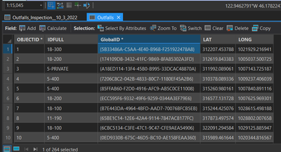

My coworker created a feature class and collected stormwater outfall data with attachments using Survey 123. Now that dataset is a feature class with an attachment table. Every time she re-visited a location she would create a new point on the map so there are duplicate locations where the points on the map are not stacked but are close spatially, and the site id is the only thing that shows that it is the same location for multiple visits. Each point has tabular data in the attribute table and photos in an attachment table.

So far I used the table to table tool to convert the previous years site visits from a feature class to a table.

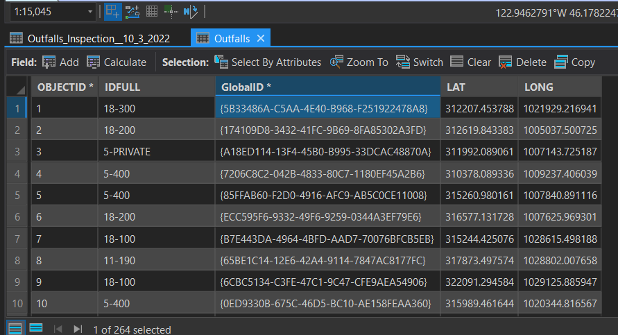

This is the feature class point layer of the Outfalls
The IDFull is the only field that is the same in the point layer and the related table, but it also had a global id field, (This is the only point layer).

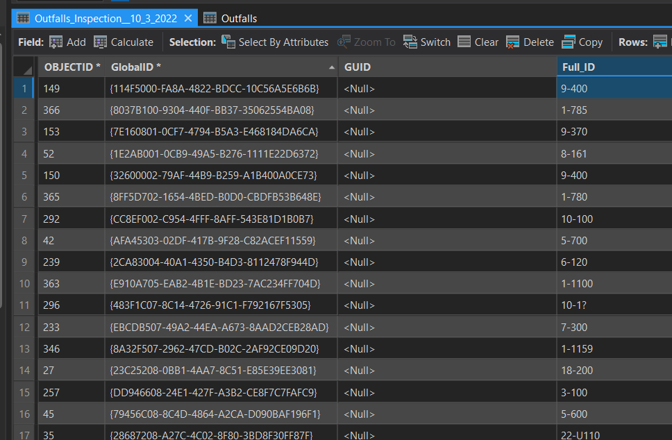

This is the merged related table. There are global id's for the previous years site visits feature class, and from the current years related table data.
The Full_ID is the only dataset that shows which outfall location the data was collected for the previous year because they didn't use the same point on the map so each time they went out they dropped a new point so it doesn't align spatially but does based on this field.
There is a GUID field  but that is only populating for new data collection in the related table.

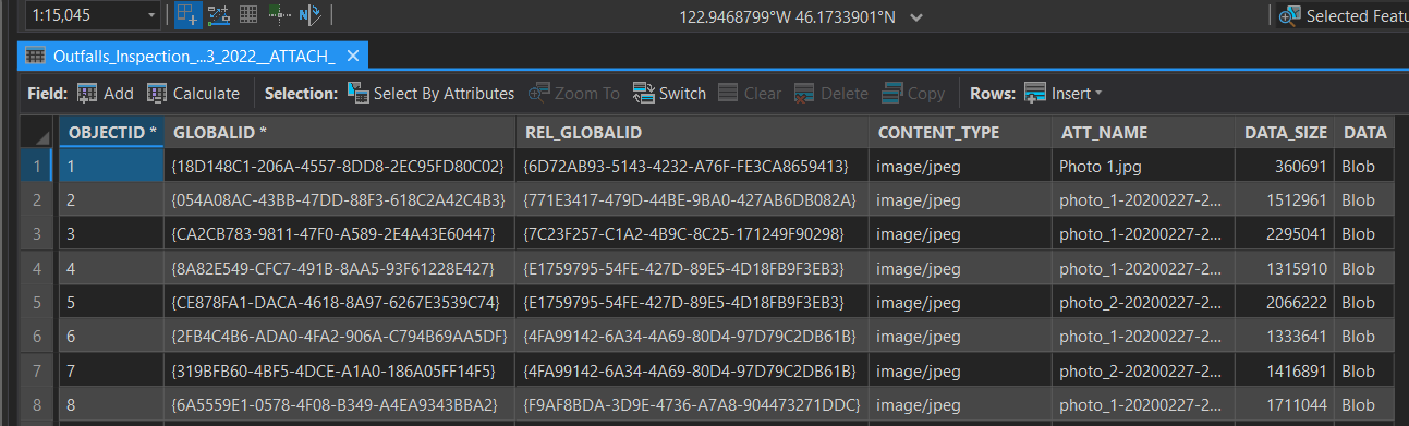

This is the merged attachments table and it has a global id and a REL_GlobablID
