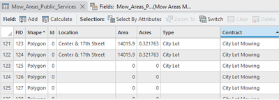

Hi there.
I am working on a dataset from a previous employee and it appears that all of their 'Area' and 'Acres' data for a polygon feature class were entered manually. So when I create new features, the attribute table doesn't automatically show the area. I assume these fields were created by this user.

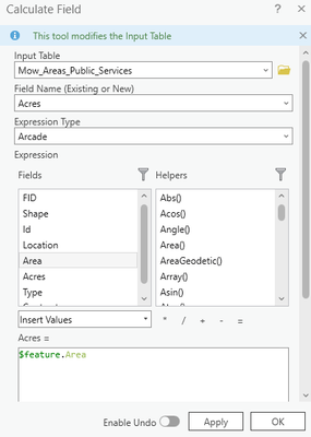

I'm pretty new to gis work in general and do not understand how I can modify this feature class/attribute table to include a new field that automatically calculates and or shows the area of new polygons I create. Let alone, I do not understand how to run the 'Calculate Field' tool as I do not understand how the 'Helpers' are used.

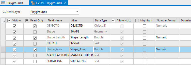

I have other Projects where datasets have things like length and area automatically calculated and it looks like it uses the 'Double' option for field 'Data Type'. I tried adding a field with this double setting in my above feature class and it is not auto calculating the area.

Hey @WDMParkPlanner and welcome to the GIS field!  So I would look into Immediate Calculation Rules to automatically calculate the area of a polygon when you add a new polygon.  You can learn more about it here.
