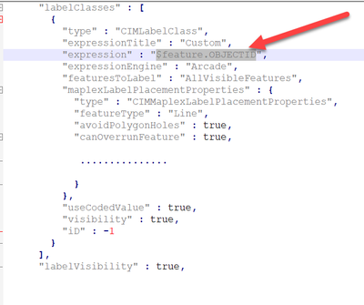

I was able to delete the LabelCLasses and labelVisibility from the lyrx file, then import symbology and only the symbology came across with no labeling or label issues.
Was also able to edit the lyrx file and change the LabelClasses expression to use a different column for labeling, then import and updates symbology and modified label column.
      "labelClasses" : [
          "type" : "CIMLabelClass",
          "expressionTitle" : "Custom",
          "expression" : "$feature.Pr_Class",
          "expressionEngine" : "Arcade",.............

I have now tested this with 2.9.3 and 3.1.1 and both work the same way.
If I delete "labelClasses": through "labelVisibility": True, (and everything in between), it will just apply the symbology from the layer file, and not the labeling.
If I modify the "expression" : "$feature.LABELFIELD", then load the layer file, it will label with that field instead of the original.
