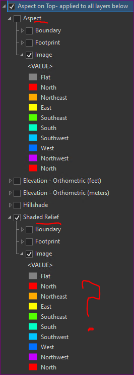

We have a raster mosaic containing elevation data where we have created an individual symbolized layer file for shaded relief, aspect, slope, elevation (meters) and elevation (feet). Each one of these layers references the same mosaic. Each of the symbolized layers are added to a single group and then saved as a single layer file as shown in the image below:
When I bring this single Raster Mosaic Group layer file into Pro 2.6 or 2.8, the symbology in Pro takes on the very top layer in the group and applies that to all the layers below. In the example image above, all those layers in the group within Pro turned to symbolize in Shaded Relief. Another Pro example shown below using Aspect as the example:

UPDATE: the raster group layer (lyr) issue in Pro was resolved with Pro version 2.9.1. Yay!
