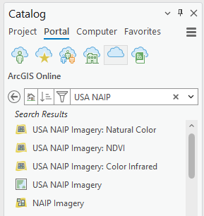

  1. Navigate to Portal in Catalog Pane, switch to ArcGIS Online Contents and search 'USA NAIP' like shown below.

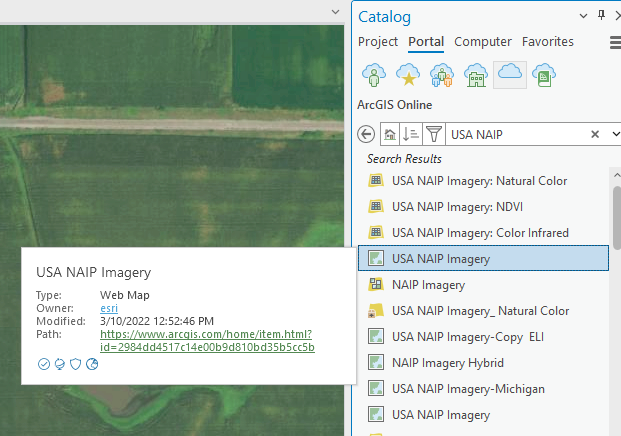

  2. Choose the fourth option which is 'USA NAIP Imagery' web map and add it to the project like shown below.
  3. Remove all the layers in the map except for the layer 'USA NAIP Imagery: Natural Color'.
  4. Since this is a Raster layer, the resolution is set to a certain value and won't change/shift when zoomed in or out.
  5. Place the feature classes above this layer and carry on with the workflow.
