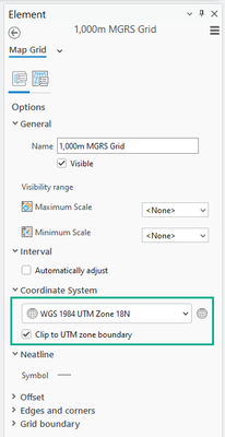

For the first problem, what is the grid's coordinate system? This is separate from the map's coordinate system. Check Clip to UTM zone boundary to only see coordinates for one zone.
