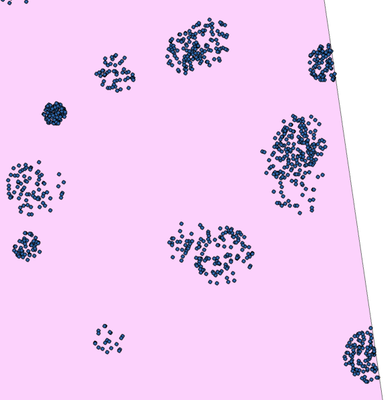

What I've tried so far is using the "Generate Random Points" tool to generate 50,000 points within my boundary, and set a low minimum allowed distance (e.g. 1 meter). Then I used the "Density-based clustering" tool to detect areas of clustered points and copied them to a new feature class. This leaves me with the clustered areas and no noise points. However with the noise subtracted I am left with far less than the desired amount of points. The output looks good but I would like to set the total number of points to be clustered. See screenshots for reference.

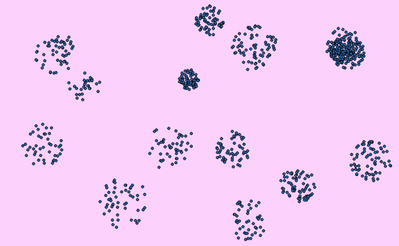

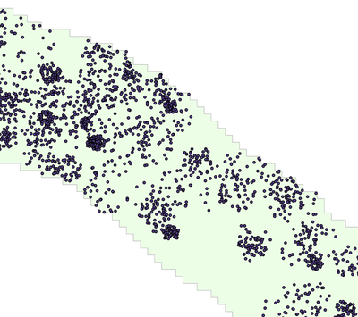

before:
after (with quite high offset values):

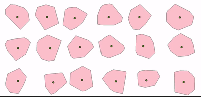

Regarding irregular cluster shapes:
This would be an easy way to generate irregular (but always convex) buffer shapes:
def irregular_buffer(point_geometry, min_dist, max_dist, num_points):
    points = []
    for i in range(num_points):
        angle = random.randint(0, 359)
        dist = random.randint(min_dist, max_dist)
        points.append(point_geometry.pointFromAngleAndDistance(angle, dist).firstPoint)
    multipoint = arcpy.Multipoint(arcpy.Array(points), spatial_reference=point_geometry.spatialReference)
    return multipoint.convexHull()
The num_points argument controls how much the buffer shapes resemble a circle. Higher value -> more circle-like.

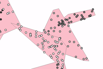

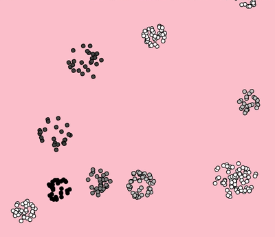

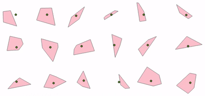

num_points = 5:
num_points = 10:
num_points = 30:
To use this method, replace lines 41-42 in my original answer with this:
            cluster_buffer = irregular_buffer(cluster_center, min_cluster_radius, max_cluster_radius, 5)
Which indeed results in more irregular clusters:
And you can still add a random offset at the end.
Have a great day!
Johannes
