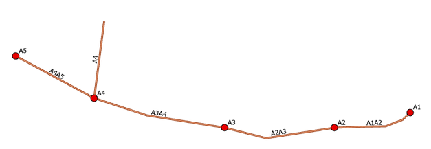

Hi Everyone,
Basically, I have a network of polyline features that connect point features. Point features are labelled A1, A2 etc. Lines are named based on the 2 point features they connect: ID = A1A2. Is there a easy way to have the attribute ID of the polyline generate based on the 2 points it is snapped to?

Arcade is your friend here.
// extract the line's start and end points
var start_point = Geometry($feature).paths[0][0]
var end_point = Geometry($feature).paths[-1][-1]
// load the point fc
var point_fc = FeaturesetByName($datastore, "TestPoints", ["TextField"], false)
// get the intersecting points' names
var i_start = First(Intersects(start_point, point_fc))
var i_end = First(Intersects(end_point, point_fc))
var names = [
    IIf(i_start == null, "", i_start.TextField),
    IIf(i_end == null, "", i_end.TextField),
// concatenate and return
return Concatenate(names, "")
Change the names of the point fc and the name field in lines 6, 12, and 13.
You can use this expression in the field calculator (switch to Arcade) or in an Attribute Rule.
