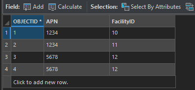

Problem: I want to get multiple records from one field(FacilityID) into one APN record in a list format that is also in numerical order.
My workflow: Spatially Joined 2 layers(one to many) and now I have duplicate APN records. I would like to have the individual APNs with the multiple Facility IDs listed in one record. I know I could always copy and paste data into excel and do what I need to do there, but I really want to learn arcade 🙂

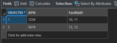

You could do this via python.  Below is an example.  It first gets a dictionary of all APNs with their FacilityID.  Then delete's all identical rows based on the APN field.  Finally, it updates the FacilityID field for each APN based off the dictionary.  You will want to make sure the field, FacilityID, you are updating is a TEXT field.

Before:
After:
