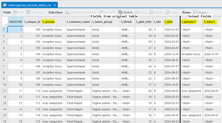

Mobile Geodatabase
I can create a view using the SQL in a Mobile Geodatabase without errors. The joined/duplicate columns are included in the attribute table. The duplicate fields are suffixed with ":1", making them unique. That's a valid way of handling the duplicate fields.

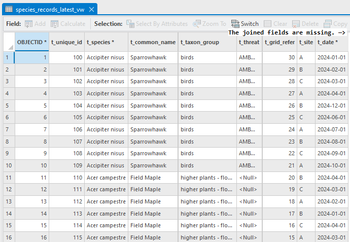

File Geodatabase
I can create a view using the SQL in a File Geodatabase without errors. However, the joined/duplicate columns have been excluded from the attribute table. That's not expected.
03528630 - ArcGIS Pro 3.2.1: FGDB database view has joined fields with duplicate names; joined fields should not be excluded from attribute table
BUG-000164420: Database View created in file geodatabase with Join definition does not create the required duplicate fields
Question:
The FGDB view should either behave like the Oracle view (throw an error) or behave like the Mobile GDB view (include the fields). But it doesn't do either of those things. It excludes the joined fields which defeats the purpose of the join and the view.
