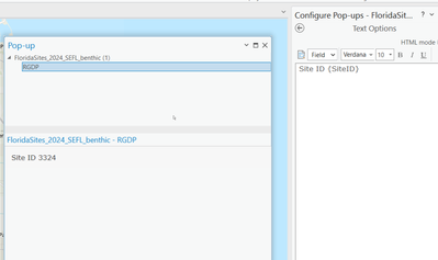

If have a field that contains all of those comments, then you should be able to use that field in the pop-up. A pop-up will have the Fields element by default, which shows you all the fields. You can also add a Text element where you can type in a specific field surrounded by curly braces . An example looks like this, with the text "Site ID {SiteID}".
