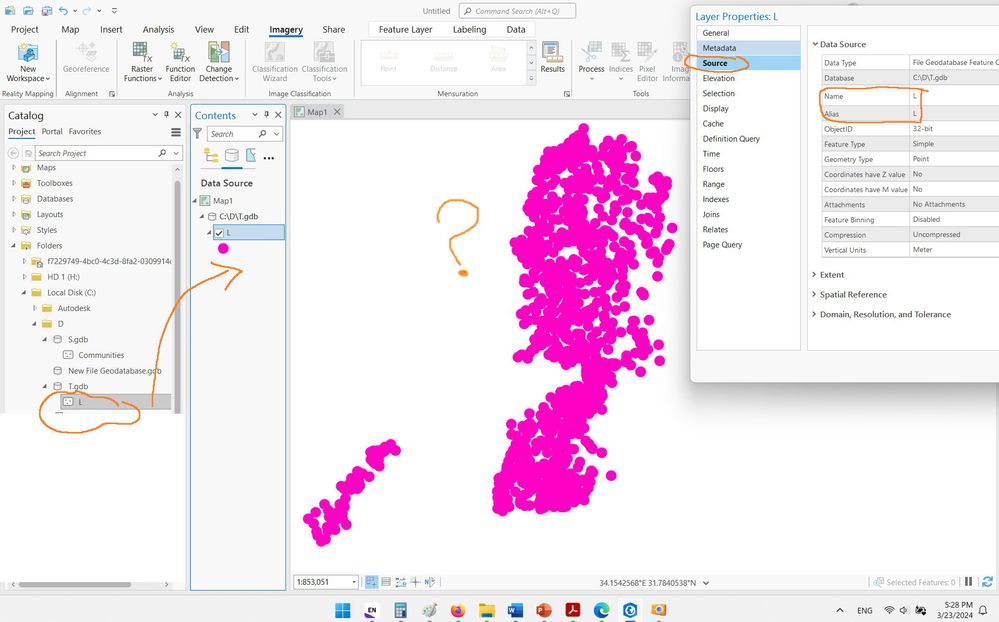

I'm encountering the same issue. As shown in the screenshot below (the data is also attached), when I add the feature class, it automatically gets symbolized and labeled.
Jamal Numan
