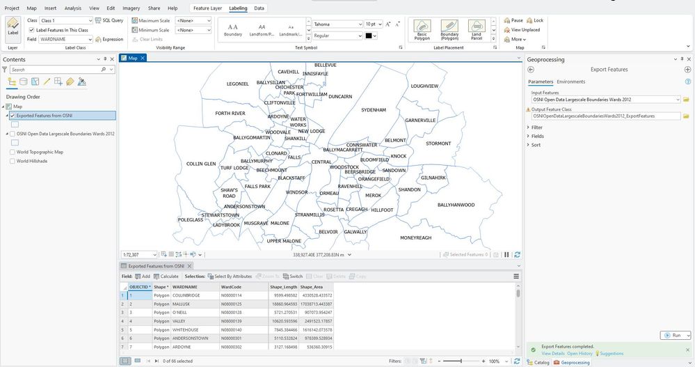

Thank you @BEN12345 - I added the OSNI_Largescale_Boundaries_Wards_2012 layer to a Map View in ArcGIS Pro and turned on labels with the WARDNAME attribute field as the labeling field.  No issues.  I selected 60+ polygons from the original layer and used the Export Features geoprocessing tool to create a new feature class in my project geodatabase.  The newly created layer was added to my map.  I then turned off all the other layers so you can see the labels when I turned them on using the WARDNAME attribute field as the labeling field in the new feature class layer.  Again, no issues.  See the graphic below.  Not sure why your ArcGIS Pro is throwing the error message.  If you go to the right of the label field drop  where WARDNAME is located on the Labeling tab and click Expression.  What is the expression?
