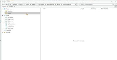

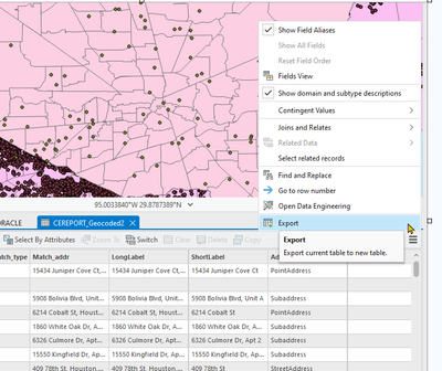

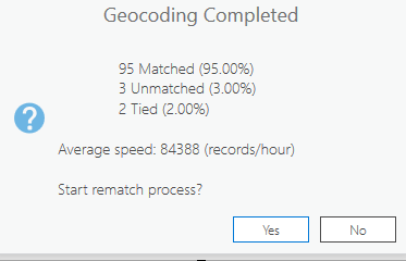

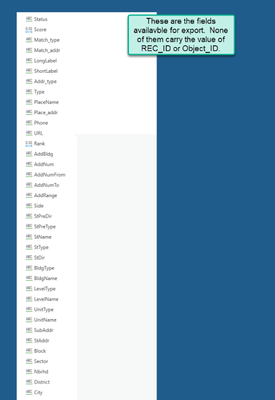

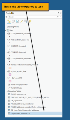

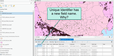

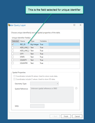

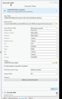

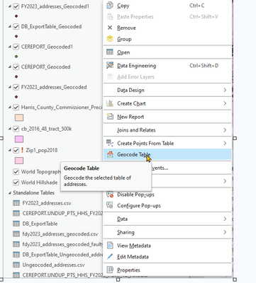

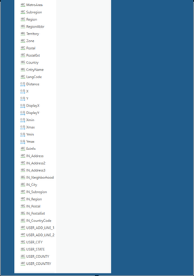

Problem appears when id field is not available for export.  why?  You have to look at the last image to see it
Table from oracle database being added to map through dbConnection
Data just added to arcgis from an oracle table
Geocoding the addresses
Export geocoding
Picking a folder not in project for saving exported data
