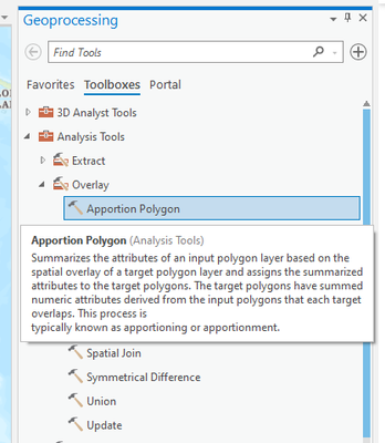

Hi Chris! Take a look at the tools available in 'Analysis Tools'.
I believe the tool 'Apportion Polygon' will meet your requirements. If this doesnt quite meet your needs, my general trick is to look through the tools in this general area and see what a best fit would be. Sometimes the solution is a couple of tools used in a workflow. Let me know how you go!
