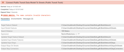

I'm trying to run the Connect Public Transit Data Model to Streets tool and I keep getting this error. It has worked before though so I cannot figure out what the issue is. I see nothing wrong with any of the parameter names? Any ideas?

What do the Messages say?

Error 000354 says it's a column name that's the problem, not the parameters. There is only one input table, BobsNetwork/Streets oh actually "Stops" looks like an input too. One of those has a column name that's weird, a special character or a space or something unappealing to the model.
Maybe try opening those two tables in Pro, and use the Data Design -> Fields feature to look for a problem.
