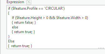

I have created two Arcade Validation rules that run the same check.  One is created using "Ready to Use Rules" (I.E. Data Reviewer) and the other in straight Arcade. The rule checks for appropriate Height and Width values in a Pipes (simple line) feature class.
In our database if a pipe is "CIRCULAR" we only populate the "Height" field (the "Width" field is "0")...so simple test of validation rules...
Arcade
Data Reviewer

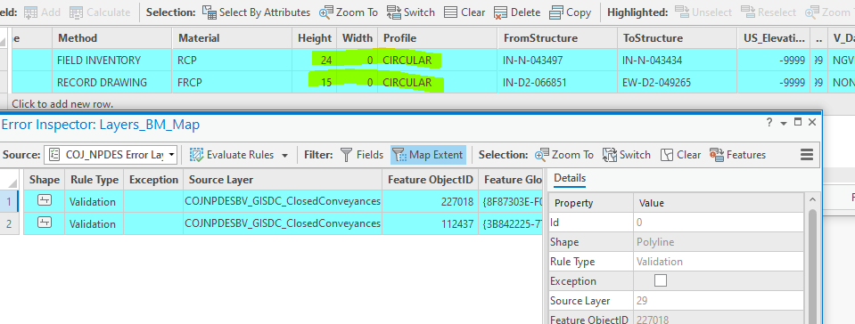

I deliberately edit two pipes in my map extent to violate the rule.  When I "Evaluate Rules" in the Error Inspector both rules correctly report the two pipes that violate them.
Here's where it gets weird, when I fix the errors and run the Error Inspector again, the rule based on the straight Arcade code does not produce an error (as I would expect), but the rule created using "Ready to Use Rules" (Data Reviewer) keeps reporting that the two pipes are errors (even though they are not).  In the Error Inspector I cannot select the two violation records and set them as resolved, my only option is "Exception", but they are not exceptions!  They have been fixed.  I want to use the "Ready to Use Rules" because esri suggests they are optimized for ArcGIS Pro (the environment we are editing in) but if I can't figure out how to make resolved errors stop appearing in the list, or at least show them as resolved, I might have to write them all in Arcade.  Any advise would be appreciated.
I edit two pipes to break this rule and they are flagged as errors correctly.  I fix them and they are still flagged as errors...

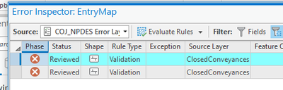

The status information you requested is below:
Can you please advise how I can set them to "Resolved" from this point? Is there a workflow document you could point me to online that would walk me through using the Error Inspector to Resolve errors?

@KimberlyGarbadeThe phase and status values should be automatically updated to Verified/Acceptable once the error condition no longer exists. What version of ArcGIS Pro/ArcGIS Enterprise (for services-based workflow) are you using?
For troubleshooting purposes, I would suggest disabling (or deleting) the Arcade-based validation rule that tests for the same error condition and then re-run the evaluation. Before evaluating the feature, please verify that the feature's VALIDATIONSTATUS field value is either 2 (No calculation required, validation required, no error) or 6 (Calculation required, validation required, no error). Otherwise, the feature is skipped during evaluation.

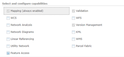

We are using ArcGIS Pro 2.8.5 and ArcGIS Enterprise 10.8.1 and SQL Server 2019
Some more info on my Map Service if it helps.

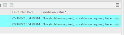

The two features I break on purpose both flag as errors with "validation required"
I fix the error....
And the pipes still flag as errors, only this time with "no validation required, has errors."

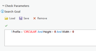

My very simple rule is supposed to check that: if a pipe's "Profile" is set to "CIRCULAR" that its Width is set to "0" (we only store dimension data in the Height field for a circular pipe, width should be 0).

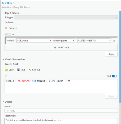

The built in validation rule finds the pipes when I edit them to break the rule, but not when I update the pipe to fix the problem... maybe it is a problem with my Built In Rule's logic:
Another mystery is that if I view the "VALIDATIONLINEERRORS" table by opening the Line Errors table in ArcGIS Pro the "Last Update" date is set to 2/18/22 even though I last edited the feature class being checked today and I last ran the Error Inspector today (2/23/22).
Its almost as if those records are "stuck" in the table.

Hi @KimberlyGarbade Thanks-much for providing the details on your deployment.
This sounds similar to a bug that the team found that was specific to errors created when using the Query Attributes check in a services-based workflow (it could not be reproduced in a FGDB). The phase and status columns of the error features were not being updated once the error condition was resolved.  The bug was fixed in the ArcGIS Pro 2.9/ArcGIS Enterprise 10.9.1 release.
