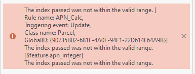

My main issue here is that this code works in the dev playground and validates just fine in the expression builder but wont run in pro, where I get the below error message. Any help with this?

Take a look at the parcel with the global id mentioned above:  my guess is it has a null value or something else goofy in one of the attributes you are trying to concatenate.

Through my testing its every selected parcel exhibits that error and our parcels are pretty clean too, so no nulls or wonkiness here. When I removed the Integer field from the script that error affects the next field, which is No Dash in this case.
I can get all this to work separately as different rules but combining them is beyond me at this point on the learning curve.
