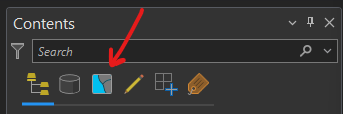

  2. You do have permissions, but in your currently-active map, the feature layer is unchecked in the Selection Tab of the Contents Pane (see image below)
