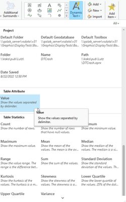

Hi,
I think the Value dynamic text element will do what you need. It can read the values directly from the table. You can choose to show values from only features visible in the map frame, all features in the layer, or a subset of values based on a SQL query.

AKitch
Thanks for the  suggestion Aubri. I did explore the options with Value dynamic text but unfortunately it doesn't do quite what I need. What I need to show is the actual attribute name. For example when I make a map of 'Species 1' using the table I posted then I'd want the dynamic text to display 'Species 1' as opposed to the values in the attribute. I've yet to find an option to do this without scripting. If I was using the Legend terminology, I want the dynamic text to be linked to the 'Heading' of a particular layer.

Ok, I understand now!
ArcGIS Pro doesn't have a dynamic text element for layer names (you could add an idea for that though!). However, there are some options you could explore. There is a dynamic text element for map name, so you could rename the map when you change the symbology. Or you could add an extra field to the table and use value dynamic text.
Maybe one of those would work? Or there could be a completely different solution. You could also look at building an SDK Add-In so you could have a button to do this instead of needing to run a script.
