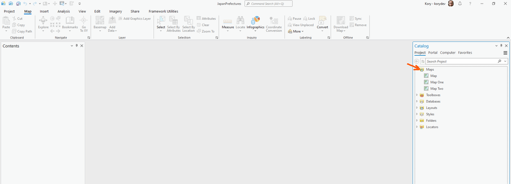

Wait? The projects open, though, correct? In the Catalog pane, if you expand the Maps container, do you see your maps in there?

Yes. Sorry, I was expecting it to open with the Contents pane full of the layers, just with broken links - I assumed it was not working based on that expectation! So, yes, I can open the project map and all is there (just broken paths). So that means all is ok and we have narrowed the issue to the Access drivers? I will contact ESRI Aus to action that.

Whew! Glad its working. Yes, this would indicate that there is still something about the driver setup that isn't quite there yet. Once those drivers are installed correctly, you should be good to go. Sorry for the hassle - these are the kinks with a major release. Moving to .NET 6 is the underlying cause of the new driver requirements. Please work with Support to get is sorted out. Thank you!

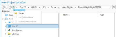

Heres a quick video of what is happening

The video is helpful. Thanks.
A couple of things:
1. It looks like you're creating and storing projects in a OneDrive location. Please be sure to read the support policy for Pro on OneDrive: https://support.esri.com/en/technical-article/000025605
2. It looks like you are typing in a location that doesn't exist. Once you are in your ThomhillNightFlight071522 folder and you want to create a new folder in there to house your project, go to New Item > Folder and create it. Then you should be able to set that folder as the location for the new project.
I got the same network location error you did when I followed the steps in your video. But when I created the folder first and set it as the location there was no problem. Hope that helps.

As I understand it when you create a new ArcPro project it creates a project folder as it has been doing since I have been using ArcPro. In the video, I am storing it within an existing folder so everything is located in one spot. This is what have been doing for at least 5 years now without any issues, So If I'm understanding you correctly I have to go into the existing "overall project folder" and create a new empty folder to then save the ArcPro project folder within the newly created empty folder?
