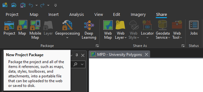

I was back on this issue today, and just wanted to add to this Solved Topic for anyone who falls upon it. I tend to maintain pretty bloated projects and run into Catalog running slow on simple tasks like Delete or Rename quite often, and I found something that seems to be working for now.
What seems to be working for me when a project gets slow is checking for any broken links in the maps. I do this by quickly trying to export the project file to disk (see screenshot below). When you analyze using this GP tool, it will identify any Data Sources that are broken in the entire project as you can't export without doing so. Using the 3-bubble icon with any error that pops up, you can get directed right to the culprit and repair the link or remove the layer. Every time I've been doing this, I notice significant improvement in Catalog operations after.
