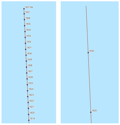

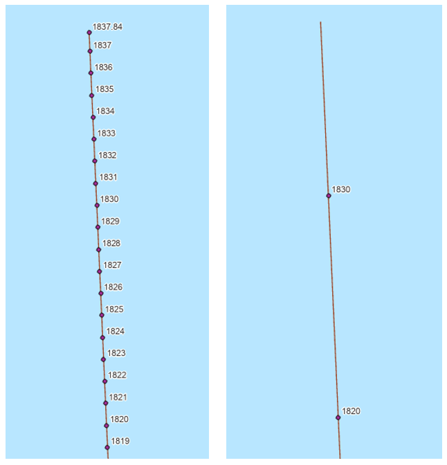

I have a line layer together with a point layer representing a mark every 1m along the line. Essentially KPs along a cable route starting from say 0 to 50. As well as a point every 1m there is a point at the end of the line. For example 1, 2, 3, 4, 5 ... 47, 48, 49, 50, 50.4 if the line isn't exactly 50m in length.
A query of MOD(MP, 10)=0 will give me a point every 10m but doesn't include the last point.
How can I create a query that displays a point every nth value PLUS the end point.

If you know your last KP value you can add an OR statement to the end of the expression to show the last vale, e.g. MOD(MP, 10)=0 OR MP=50.4
This works for a layer in an FGDB.
