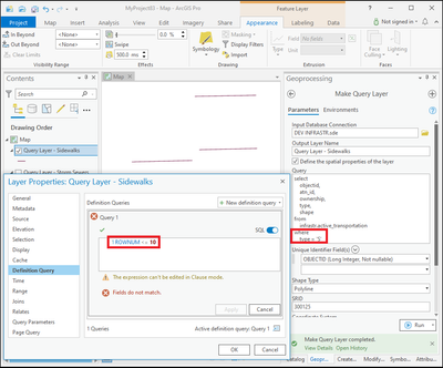

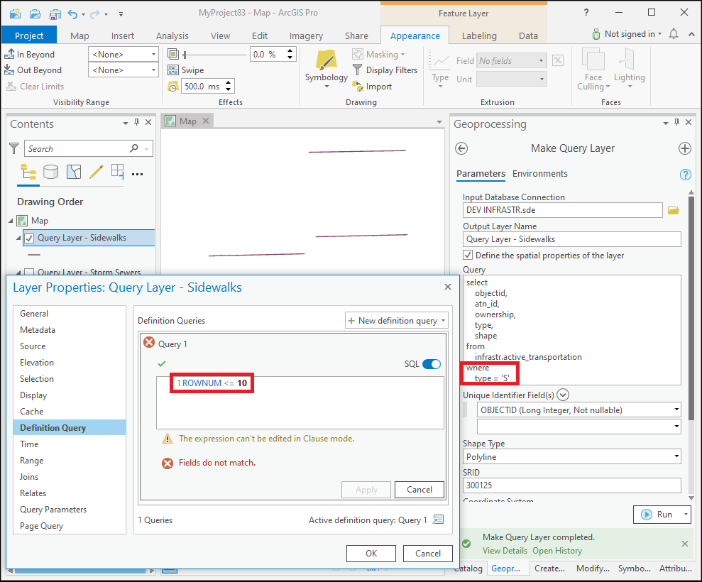

I noticed recently that it's possible to create a definition query on a query layer:
I suppose that makes sense. All feature layers in the Contents pane have a definition query section in the layer properties, including query layers.
Out of curiosity, does anyone ever do that -- have a query layer that has a WHERE clause in the SQL definition, and have a definition query too? If so, what's the use case?
It might seem a bit strange to have WHERE clauses in both places. But I suppose definition queries are more convenient to modify than query layer SQL definitions, so maybe that's a reason to do it?
