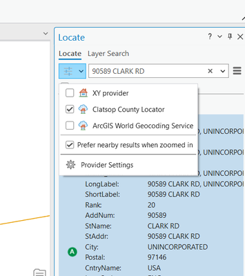

Here's a picture of my Locator successfully finding 90589 CLARK RD as typed in by me. Observe, SCORE=100

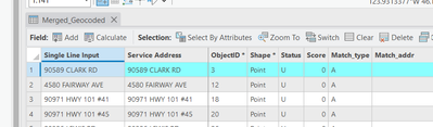

Here's a picture of the same feature in the output of the tool. Of note: SCORE=0

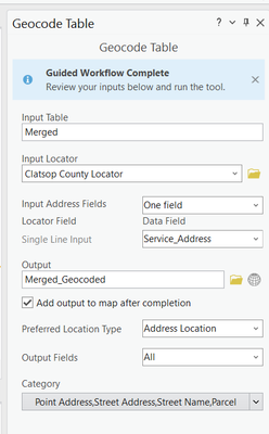

Here is a picture of the Geocode Table set up, I have tried other options, the results have been exactly the same every time: 226 rows don't match.

@Brian_Wilson It looks like you built your locator with city and zip code (location), but you are not using city and zip code when geocoding the table. When using the Locate pane it uses the center of the map as the location, while batch geocoding a table does not reference the map to get the location, the location (city, zip code) needs to be included in the input table since your locator was built with city and zip code mapped.
If you launch the Rematch Addresses pane to review the unmatched addresses are you getting candidates for the unmatched addresses?
