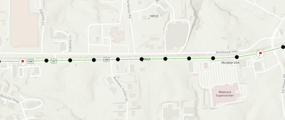

GerhardMaree1
Please see the image attached.
The red flags is the mile posts I used to calibrate the routes to.  The black dots is a 1/10 of a mile marker symbols placed at measured units along that route.  I basically want to export those black dots to a separate feature. Ideally using "create points along line" would be ideal but it still uses the distance and not the calibrated measure.
Creating a table to state the measure fields where each route is unique in terms of start and end seems clunky for a fairly simple exercise.
Regardless I will give it a try. Thanks @AyanPalit
AyanPalit
@GerhardMaree1 Thanks for posting the graphic. So you have the route calibrated correctly.
