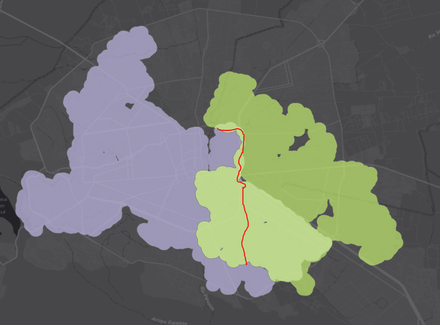

I need to create a polygon showing where my customers live (several million) for each of the locations of my stores (150)
Visually, it is very simple to see where they are:
The problem arises when I need to create a polygon in order to run some additional analysis down the road like demographics and such...
Any ideas? I tried running HotSpot Analysis, but it is very very slow even when doing it for only two stores and 100k customers as a trial...
cheerrs and thanks!

HectorBorro1
Deactivated User
Last, but not least...
how can I remove half of the overlapping area between 2 catchment areas we defined using the abobe process?
I tried Intersection but then I end up with only one area in the midlle...
The resulting polygons should not overlap...

HectorBorro1
Deactivated User
Tried that already... I need the Inverse Union, or a scissor that cuts the overlapping area in 2 so I get 2 distinct areas that do not overlap.
Something like the Create Thiessen Polygons—Help | ArcGIS for Desktop but that works only for points...
Maybe the Split—Help | ArcGIS for Desktop may work, but I don't have a Split feature. The split feature would be half of the intersection between both catchment areas...
DanPatterson_Retired
MVP Emeritus
a quick edit would do it since your splitting feature isn't one of the polygon boundaries, but a polyline.
HectorBorro1
Deactivated User
Dirty but it dos the trick. Super help, many thanks!
