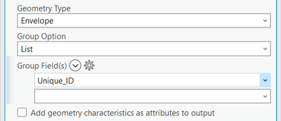

If each set of lines has a unique ID or field value, you can try the following:
- Use Minimum Bounding Geometry with Envelope as the Geometry Type, List as Group Option, and the unique ID field for grouping. The output contains rectangle polygons, each represents a set of lines with the unique ID.
https://pro.arcgis.com/en/pro-app/latest/tool-reference/data-management/minimum-bounding-geometry.ht...
Added a note here:
The default Geometry Type, "Rectangle by area", may work better.
- Run the Feature To Point tool with Centroid option on the output envelope polygons to obtain a point for each polygon.  Is the result what you are looking for?
