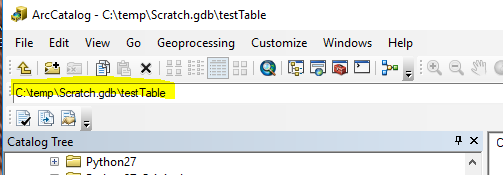

Is there a way to copy the path from catalog pane in Pro (2.4 in my case) as you can in ArcCatalog?  It's real handy when writing python :
I can just highlight the path to the table above and paste it directly in my python window:
tableVariable = r'C:\temp\Scratch.gdb\testTable'
That should just about do it....

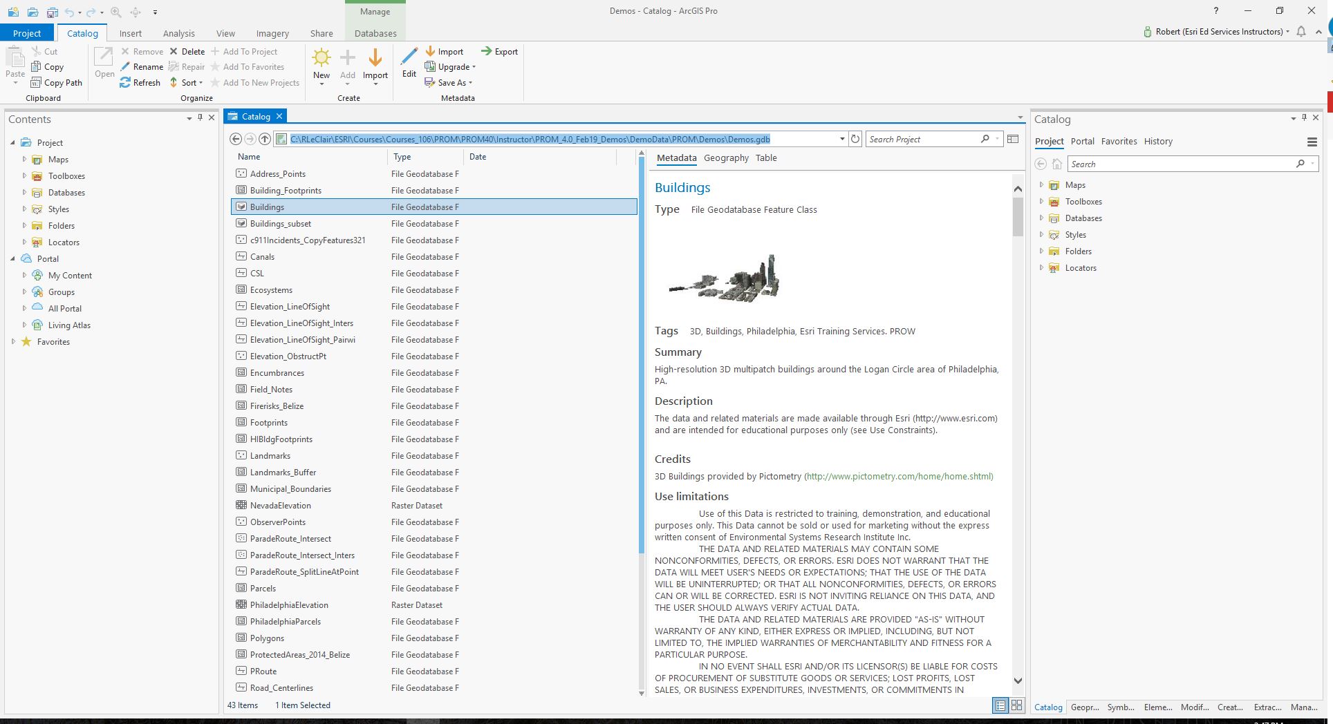

Joe - yes there is.  In the Catalog View (not Catalog Pane), navigate to your data source and click the "path" box to the left of the Search Project UI top center of the Catalog View.  Click in the box - the path is highlighted.  From there, do a right click->Copy.  Voila - the path is copy and ready to paste in your Python script!

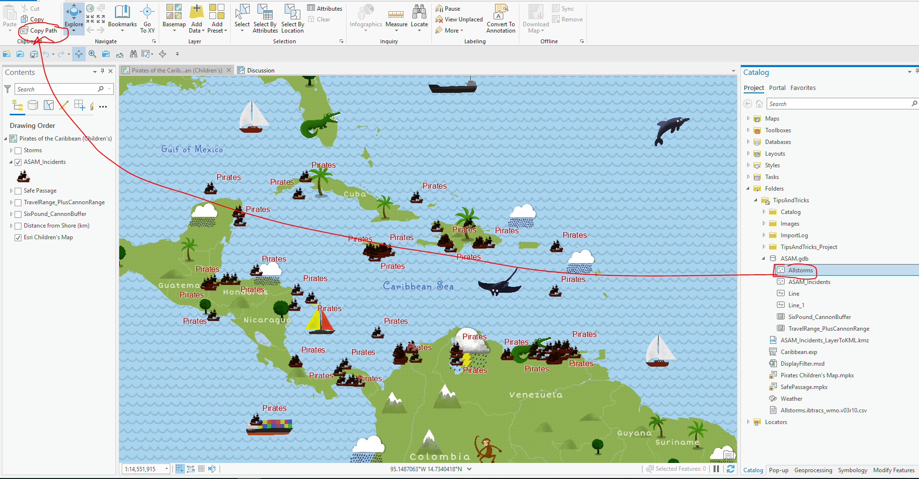

You can also use the Copy Path option from the Clipboard group - from either Catalog View or Catalog Pane:
