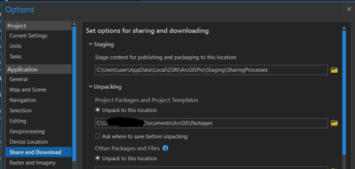

I know you've asked this question some time ago, but I thought I'd add the resolution in case others came across this issue, too.
You are able to change the Staging Folder location in ArcGIS Pro -> Options -> 'Share and Download'. The first setting 'staging' allows you to manually specify the staging folder.
