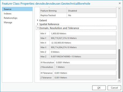

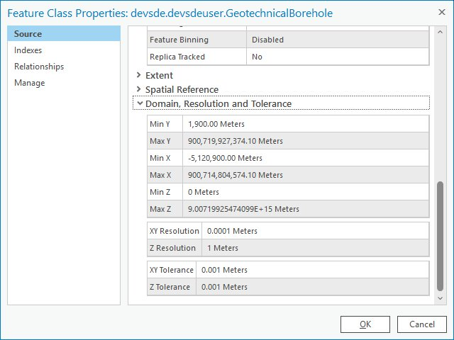

I tracked down feature 2932 and figured out the issue was a negative height. Its a borehole that was conducted underwater so it has to have a negative height for the holes AHD height. I then noticed that the egdb version has the spatial domain below.
Ah a Min Z of 0, found the issue. My problem is I can't change it. I've made new feature classes and feature datasets and can't find anywhere to set the spatial domains. I then used a custom CRS which worked on the fgdb but not the egdb as shown below (I've highlighted the min z param). Copy/paste doesn't work either.
