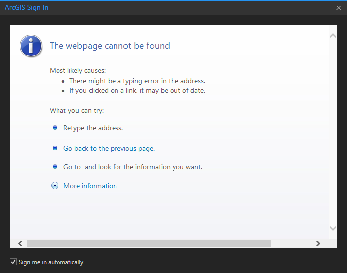

We are currently testing adfs 3.0 on our internal portal.  Works fine to access it through any browser using my Active Directory log in.  (I'm allowing both AD and Portal managed logins until we get any problems worked out)
I can also log in to our portal through ArcGIS Pro using my Portal managed username and password.  Our ArcGIS Pro license is still managed by AGOL so there aren't any licensing issues.
However, when I try to login to our portal through PRO using my AD credentials I get the following page after entering in my email and password:
I'm guessing I'm just missing some IIS setting or maybe a setting in adfs, I just don't know what it is.

How big is your AD forest? ADFS is essentially unusable with Portal if you have more than a few thousand users in the domain. And what are your ssl settings? ADFS -> Portal is very sensitive to cert properties. If you are using SSL, does your cert have a SAN property set that resolves to the FQDN of the web adpater?

can you run fiddler or wire shark while logging on? The IE page indicates that https traffic from Pro to PTL is being blocked.

When trying to connect through the adfs login:
1:  /portal/sharing/rest/oauth2/saml/authorize   HTTP/1.1 302 Found
2:  Tunnel to adfs server  HTTP/1.0 200 Connection Established
3: adfs server:   /adfs/ls/?SAMLRequest=blahblahblah  HTTP/1.1 302 Found
*Errors start
4: adfs server:   /adfs/ls/wia?SAMLRequest=blahblahblah HTTP/1.1 401 Unauthorized
5: adfs server:   /adfs/ls/wia?SAMLRequest=blahblahblah HTTP/1.1 401 Unauthorized
6: adfs server:   /adfs/ls/wia?SAMLRequest=blahblahblah HTTP/1.1 400 Bad Request

There is some dark magic occurring with your ADFS configuration, but can only be solved by your AD admin. Suggest getting him, and Tech Support, on a conference call.....suspect it's an issue with your ssl certificate.
