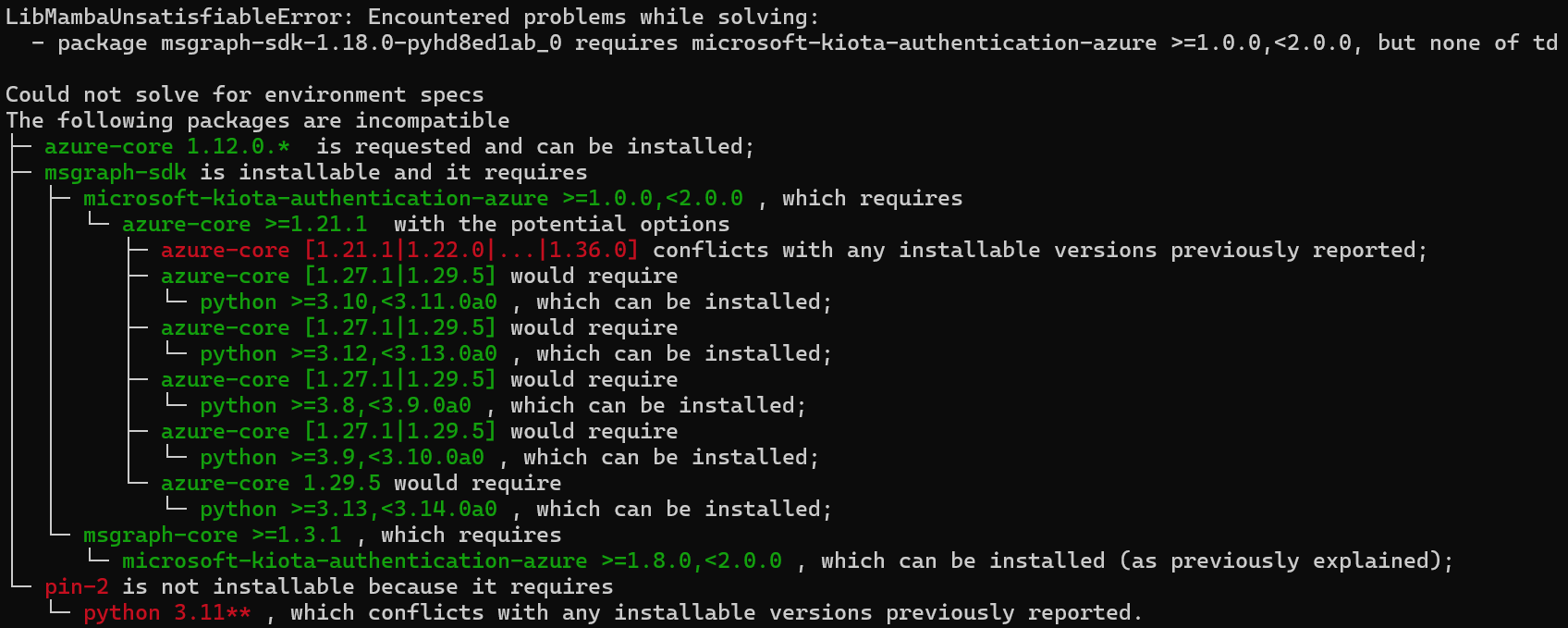

Conda refused to install msgraph-sdk (Microsoft Graph) package into a cloned 3.5 environment.  The error message complained that I need python 3.11, which is what I'm running. (see below).
Pip also refused on first try, suggesting I set LongPathsEnabled to true in the registry.  After doing that conda still failed with same error, but pip installed successfully.
Does anyone know of a good test script to run to make sure msgraph-sdk hasn't broken something arcpy-related and vice-versa?
I've read conda is better than pip at ensuring package compatibility, so I'm a bit leary.

hey dude, I have hit that before msgraph-sdk installs cleaner through pip than conda in older environments. After pip apk install, just run a quick import test for both arcpy and msgraph in Python to check conflicts. If both import without errors, you’re good to go. Conda sometimes lags behind on newer package builds.
