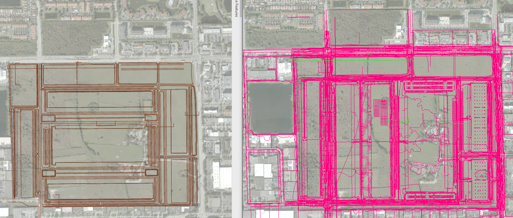

Hello!
We've recently noticed that CAD files aren't coming in with all the layers, etc. in Pro, but shows everything fine in ArcMap. We looked at the Def query for the overall line layer and turned off frozen, but this is all that came through. Our workaround was to export to GDB in ArcMap and then all the lines came in when added to Pro.
Below image, left is Pro and right is ArcMap. We are aware of XRefs and how they may play a role, but it works sometimes, and doesn't other times, so we think it's on CADs end, but can't tell them how to fix it. Any advice is appreciated.

BUMP for visibility. We've definitely isolated it to an issue with XREFs but can't figure out how to fix in ArcGIS Pro aside from asking for all XREFs and adding them individually to find what we need. Why don't XREFs come through when adding a CAD File in Pro? I would assume it's because Pro can't find them, but why can ArcMap?
