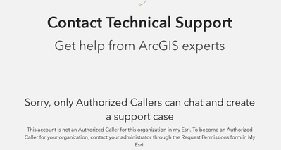

isohel
Excellent suggestion. I am not an "Authorized Caller" for my organization so I would have to go through my Administrator. This bug is primarily a nuisance and doesn't seem urgent. I would take my own time to report it, but I think the admin probably have bigger issues on their plate, so I'm not going to pursue it personally. If anyone knows of a way to report bugs that is open to all users, please share.
Edited to clarify that the bug is a nuisance, not calling tech support.
