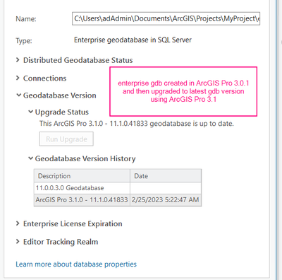

Hi Robert,
Thanks for pointing me to those bugs. However, after installing ArcGIS Pro 3.1 into my machine and running through the editing branch version data workflow, my standard portal user is still able to post their edited branched version back to protected Default. I am using Microsoft SQL Server 2019 and ArcGIS enterprise 10.9.1.
EvaTTA
Hi Robert,
I continued to do some testing after posting the above reply. I created a new enterprise gdb using ArcGIS Pro 3.1, proceeded by creating and publishing a branch feature layer to my 10.9.1 portal. Then, I set the DEFAULT access to Protected. Afterwards, I created a branch version using my portal standard user and tried to post back to the Protected DEFAULT. Only then did this workflow result in the expected behaviour that the portal standard user (aka the editor) CANNOT post their edits in their named branch back to DEFAULT. I've added screenshots of the 2 different enterprise gdbs I tried the above workflow:
SamSzotkowski
Hi Eva, I was facing a similar issue where users could edit protected default, and I found that regardless of the enterprise gdb settings it was still happening for me.  In my case it turned out to be certain administrative Portal privileges messing with the default version access/bypassing the version management privilege.  So if the issue comes up again that may be another thing to test.  https://community.esri.com/t5/data-management-questions/protected-default-still-allows-edits-posting...
