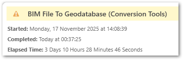

For closure, it was due to an issue with one IFC file in the 180-file collection.  It could be the bug Dan referenced, but I have not yet confirmed the issue.
When that one file was excluded, the tool worked as designed:
