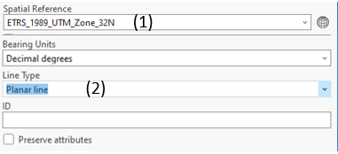

Klaus_B_Vestergaard
Hi @DanLee
Good to see that "Planar Line" is now an option in 3.0.2 (I've never got to use it in 2.9) ;o)
However, it's a bit confusing, that in order to pick "Planar Line", first you have to pick a projected coordinate system.
Intuitively, I'd look for "Planar Line" first in the drop-down as Line Type comes first in the GUI, before Spatial Reference.
As the default Spatial Reference is GCS_WGS84, you don't get to pick "Planar" from Line Type.
Picking a projected CRS in Spatial Reference first, then scroll down to pick Line Type would appear more logic - to me at least?
Regards, Klaus
DanLee
by Esri Regular Contributor
I agree with you from logical point of view, especially now the Planar Line option and PCS (projected coordinate system) are supported. However the parameter ordering on the tool dialog has been there for many years; most of users who want various geodetic lines may not need to worry about the default SR. Switching the parameter ordering now may confuse existing users; and more impactfully it may require updates to existing user documentation or guidelines. I am certainly concerned about that.  🙂
Having parameter ordering on the tool dialog different from python syntax which absolutely cannot be changed may also cause confusion and mistakes. We usually would avoid that unless the change is widely request and justified.  Such change does happen but very seldomly.
