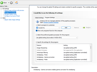

That's quite impressive you have. I'd like to help you since my office laptop and home PC are fast enough for ArcGIS Pro. My office laptop is ASUS ROG G16 (SSD NVME, 32 RAM, NVIDIA RTX 4050). Just want to clarify, are you using NVME in your C-drive. Then, does your Nvidia feature active to accelerate your ArcGIS Pro?  I do not have experience using gpu workstation, for common or gaming gpu usually it enough for desktop
Usually in my case, if the NVIDIA runs the ArcGIS Pro performance is quiet good when rendering the data and editing the feature class.
