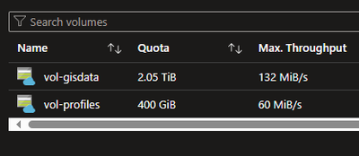

My only advice is to migrate both FsLogix profile containers AND GIS file share to Azure NetApp files and stop fussing with Azure Files (all storage/transaction tiers).
We have 1 Azure NetApp 3TB capacity pool (premium tier) that's used for /profile and /gis shares and have had zero issues since my above thread reply. We opted for manual throughput, so that we could favor the /gis volume and assign it 132 MiB/Sec. The profiles are a bit slow to sign-out due to the throughput bottleneck, but we just advised users to sign-out of AVD, then minimize the AVD session and go about their business on the local PC. FsLogix eventually completes all communication with the profile container in netapp and signs-out w/out any issues.
