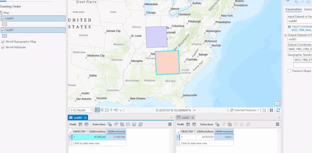

Hello GIS friends,
I'm trying to save an Attribute Rule in a polygon feature class with WGS 1984 Web Mercator (auxiliary sphere) projection and it is not saving. However, when I put the same Attribute Rule for a feature class in NAD 1983 UTM Zone 16N projection it gets saved.
This is what I'm putting. round(Area($feature, 'acres'),1)
Thank you for your help.
Abi

Weird. Does it change if you use AreaGeoDetic() instead?
AbiDhakal
@AlfredBaldenweck - When I put
AreaGeodetic(Geometry($feature), 'acres')
for a feature class in WGS 1984 Web Mercator (auxiliary sphere) projection it does not save. It verifies the expression to be correct, but it does not save. Also, when I put that expression for a feature class in NAD 1983 UTM Zone 16N projection it verifies it wrong.
AlfredBaldenweck
MVP Frequent Contributor
If by verifies it wrong, you mean it returns a different value, that's expected. Area and Area Geodetic measure differently.
Testing it out myself, I also get that error for the NAD83, so that's fine.
I'm testing in a file geodatabase in Pro 3.1.3, and it's working for me
Make sure you have the following if it's just a problem literally saving the rule:
  1. Rule Name
  2. Description
  3. Field
  4. Expression
  5. Triggers
I frequently can't save because I forget the description.
AbiDhakal
I have these and I'm still not able to save.
1. Rule Name (Get Area)
2. Description (Get area)
3. Field (GISAcres)
4. Expression: AreaGeodetic(Geometry($feature), 'acres')
5. Triggers (Insert, Update)
Thank you for trying to help me.
AlfredBaldenweck
If it's red, mouse over it to see what the error is.
Ohhhh the other thing that I forgot: The feature class must have GlobalIDs enabled. That's bitten me several times.
AbiDhakal
And the bite took a chunk out of me; it's been very painful so hopefully I will not forget this one. Thank you! That did it!
