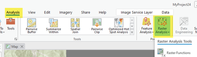

If you are trying to get a code snippit you can run Calculate Distance from inside the Pro Application. In Pro if you log into your Portal and have the correct setup and licenses to use Raster Analysis, you are able to access Calculate Distance from in the Pro Application. You can access this tool in 2 places:
1) In the Geoprocessing pane, in the search bar type the name of the tool.   (Or in the Geoprocessing pane next to Toolboxes, it says Portal.  Click Portal and you can see Raster Analysis Tools toolset, and in there is the Use Proximity (Legacy) toolset.
2) On the Analysis Ribbon --> Raster Analytics
After you run Calculate Distance in Pro you can go to the history, right click the successfully run tool and select Copy Python Command, then use this command in your script- if your script is setup to access Portal.
